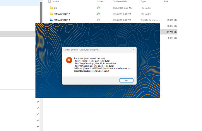

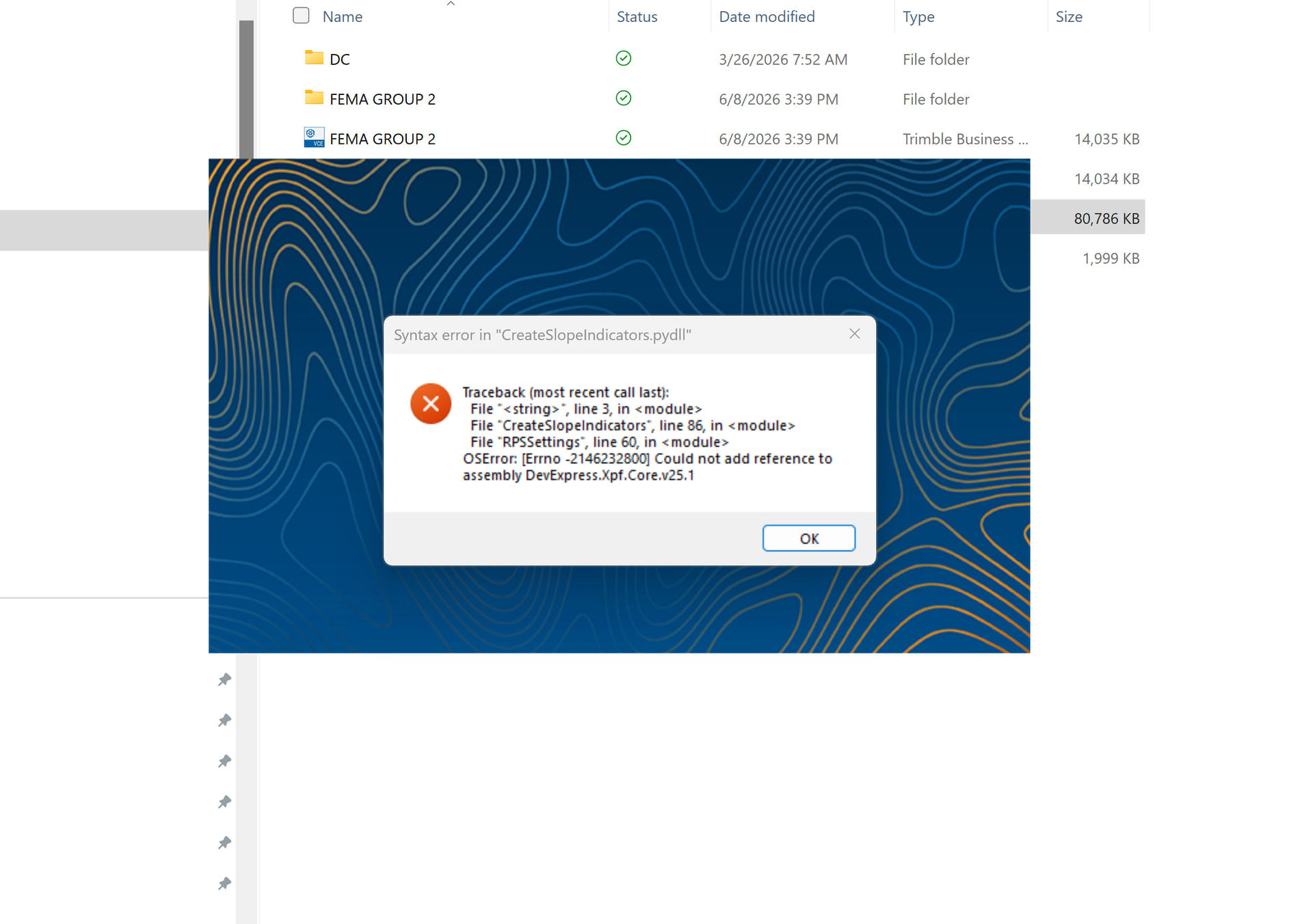

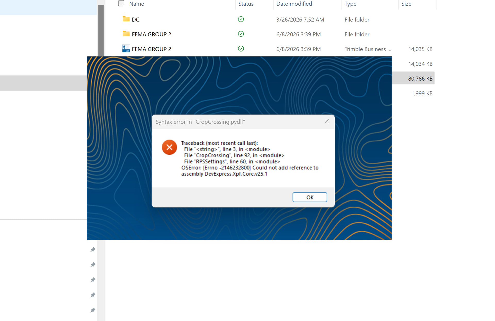

This happened after running TMLStatus command. Now, in order to open TBC, I have to click through about 30-40 of these syntax errors before it opens up. Any help is appreciated.
You need to download the TML status from their website and reinstall it that way.
https://tbctmls.rockpilesolutions.com/Files/RockpileSolutions_2026.20.exe
Erik is correct. If you are in an older version of our tools (prior to the latest release) you need to download a fresh install package to upgrade to a new release. After our 2026.2 release, you should be able to do this through TML Status.
