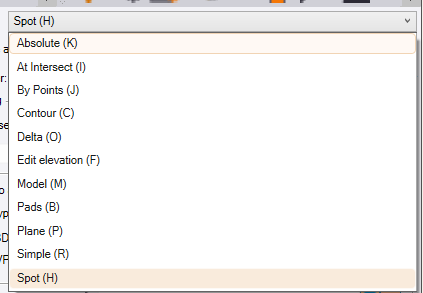

A potential method is to offset the EP line (I assume it is elevated) 3’ or enough to sandwich the points between the EP and the offset line. Create a surface using those two lines. Then select all your points and elevate them based on the surface just created.
The above method by Change elevation by surface or use absolute then right click along line option.
