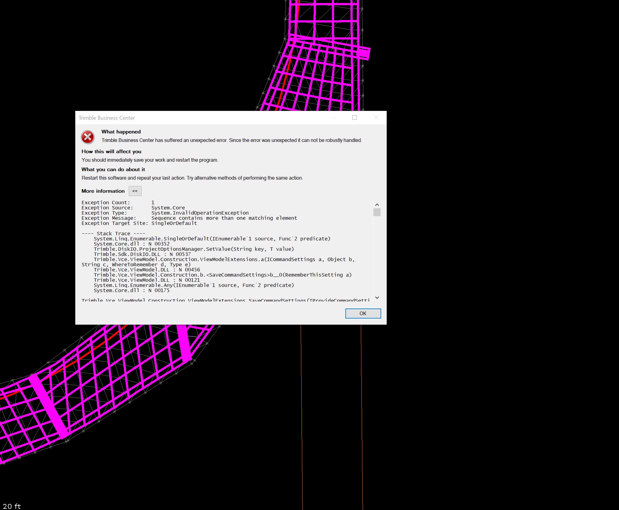

I updated to 2024.10 yesterday. today i am getting this error when attempting to publish to works manager.
I uninstalled, ran cleanup utility, and re-installed and the error persists. The error also comes up when i simply try to “create design”. Is anyone else having trouble?
