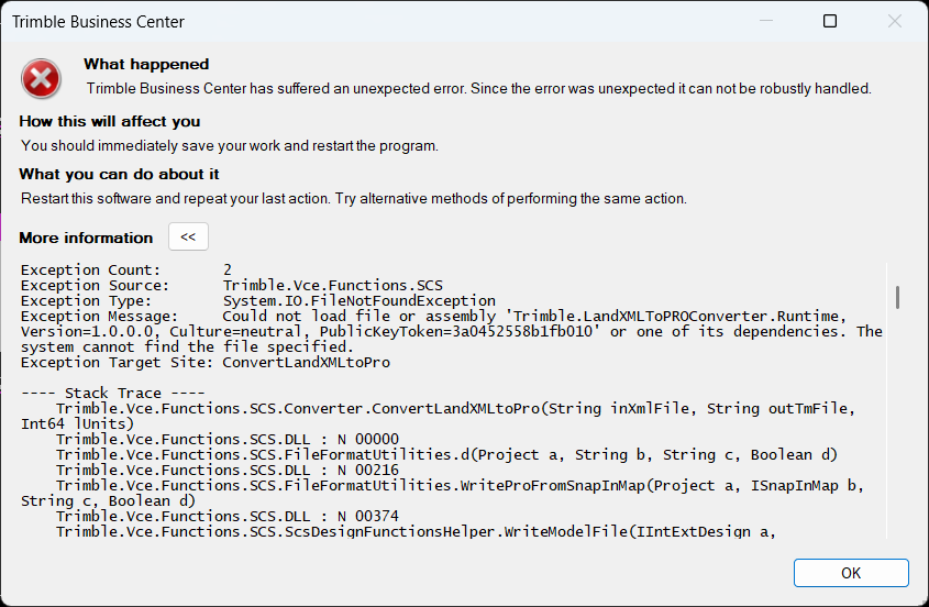

Since upgrading to TBC 2025.10, I cannot select Alignments for Model Type under the Job Site Design Manager. Every time I select that option, I get the following error message:
Has anybody else tried utilizing alignments and received the same error message?
Thanks
What are you exporting this to? Earthworks, GCS900, ect?
I’m trying to export the alignments to data collectors (Siteworks).
Use the WorksManager workflow instead.
