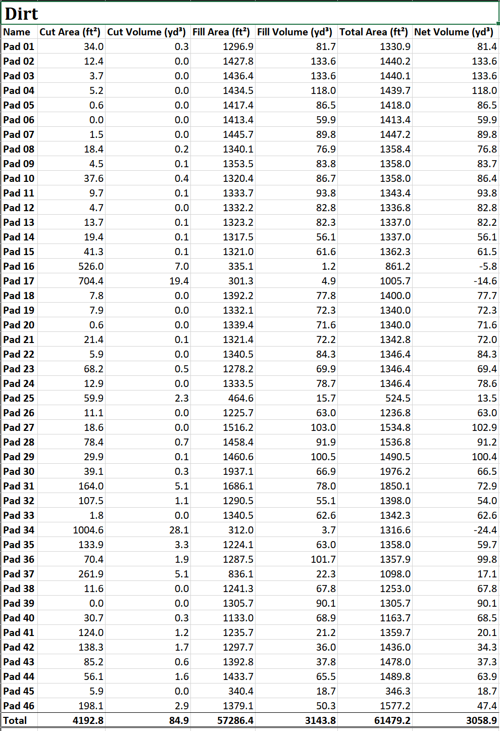

Volumes Manager inverting net volume between project and excel report?
Is there anyone else this is happening to? If so is there a reason it inverts the net volume when you export to excel?
Grady,

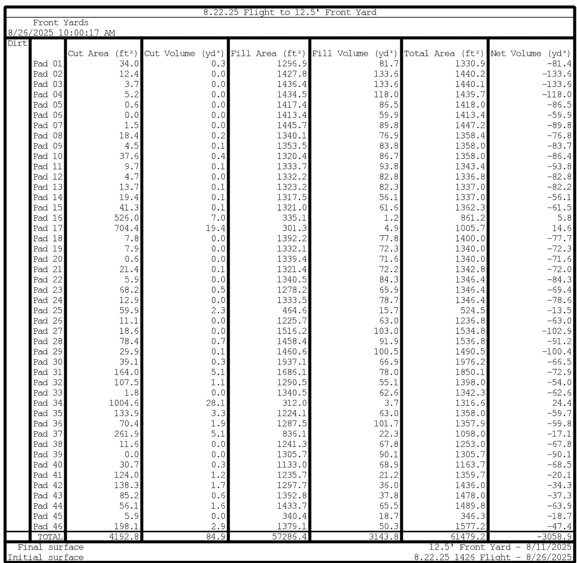

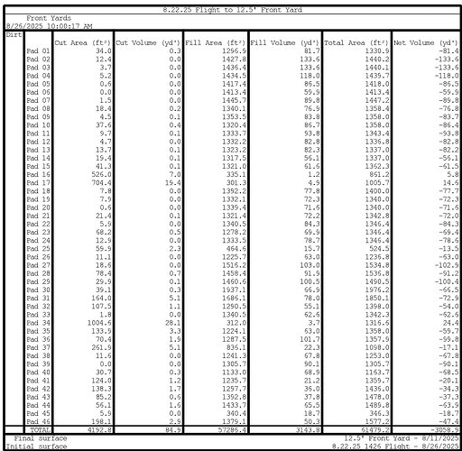

Seems they have it in TBC as Cut - Fill
In excel its Fill - Cut
I can confirm this. I kicked one out two weeks ago and went back and looked yesterday after reading this. It also did not add the first line to the totals.
