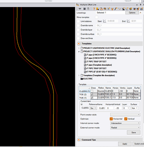

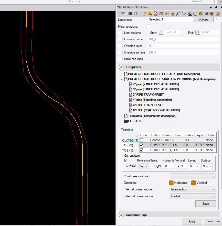

I can not get Multiple offset to correctly offset thru arc segments. I don’t know if there is a setting I am missing or if I have done something wrong. To start with I thought it was because the arc is was dealing with have a small radius. So I drew a linestring with larger arcs in it as well and it behaves the same way. See screenshot

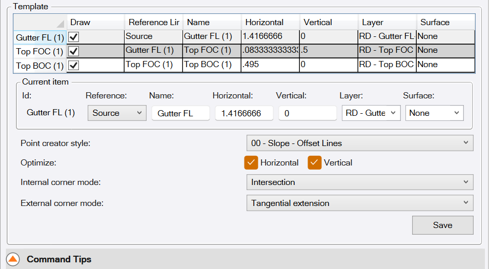

I think you need to choose a point creator style.
Thanks, I didn’t think about that changing anything since I was wanting it to output lines, not points, but changing that made it work.
