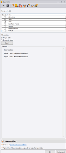

The Export LAS command dialog looks as follows:
Select region(s):
All the Point Cloud Regions in the current project are listed in the table. In the Selected column, check the boxes for the Point Cloud Regions that you wish to export.
You can resize the table area of the dialog using a right-click and drag of the mouse when over the table area.
File location:
The LAS files that are exported can be created in the current project’s Project folder, or you can browse for and select a folder on your computer / network. Select either the Project folder or Browse for folder option.
EXECUTE
Export
When you tap Export, the selected Point Cloud Regions will be exported to LAS files in the target location on your computer. The command will prepare itself for another selection set and repeat process execution.
Results Pane:
The Results Pane will show you that the Point Cloud Regions that you selected were exported successfully to a .LAS file.
