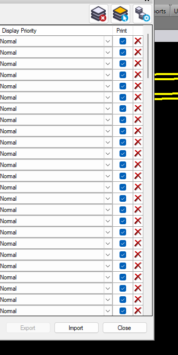

or long form. relayer that unwanted item. maybe new layer as the same layer name with no printed added. in the layer manager there is a print option that you can check off. I have never tried that.
