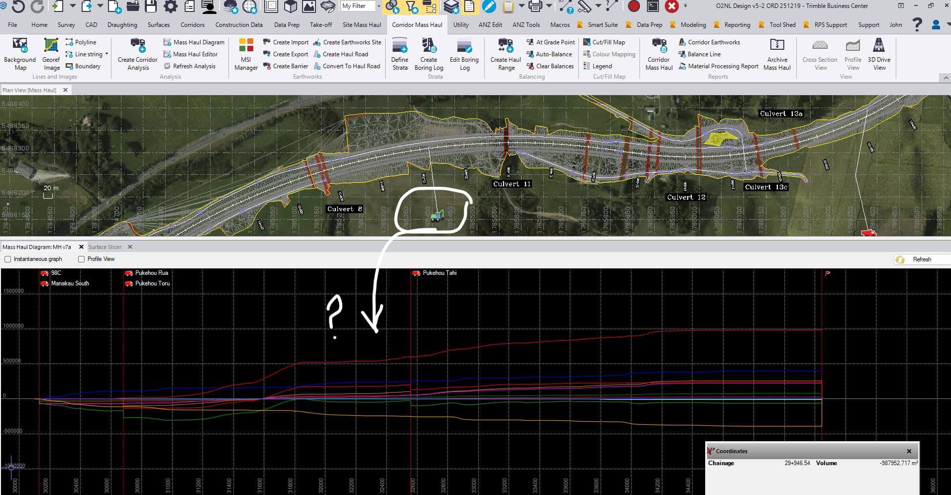

Hello,
Any suggestions why my Corridor MH won’t “pick up” / use my Borrow Pits?
It will use my Waste Sites but just can’t seem to get it to recognise my Borrows - I’ve even tried adding a Test site in the middle of the project but that doesn’t work either,
Yes - Haul Road crosses Alignment, Borrow Pit has defined Material volume - ahhh I’ve just tried an undefined volume and that worked… looks like I’ll have to dig deeper as to why I can’t use Earthen or Earthen (select) materials
