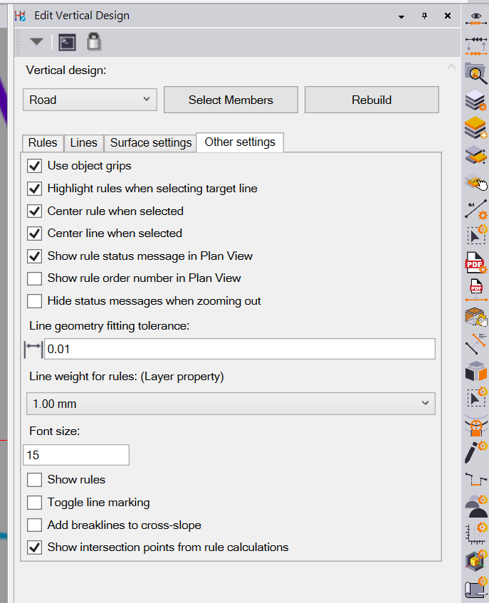

All,
I am new to using vertical Design. For some Reason, it will not allow me to check the Show Rules Toggle. I deleted the design and started from scratch to no avail. I have also restarted TBC. Is there a hidden setting someone knows about?
All,
Off the top of my head Dave I don’t know - I will ask Chris or Shane to take a look for you
Shane Helped me. It was a View Filter Issue. I deleted the filter and recreated and the problem was solved.
