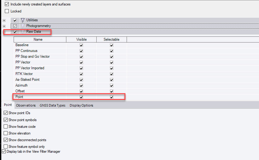

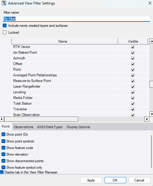

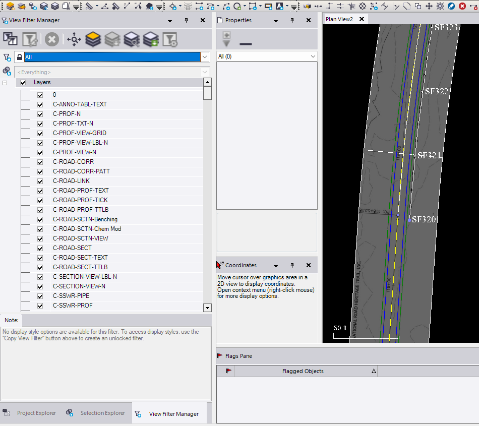

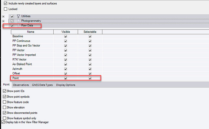

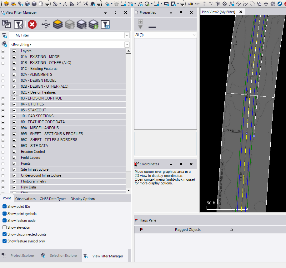

I could use some Help making my points visible. If i use the All Filter, I can see my points, but if I am in my filter, I cannot. Any ideas?

I have verified the layers are checked.
Uncheck Show feature symbol only
This was the problem. Thank you, Erik!
