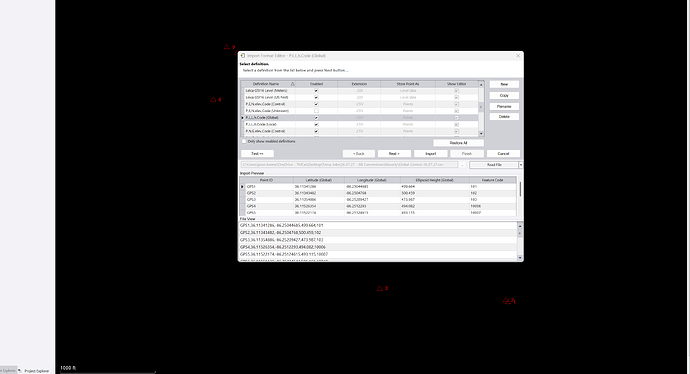

The issue is when i am trying to import the global PLLHCode csv. I drag it over, and the importer shows me the correct data, however when i hit import, a new Lat and Long are created for that point and it skews the points.
I have included the files below, can someone see if they have the same issue. Im using TBC 2026.10. Again if i just copy and paste this same information into a new point i create, the points go where they should, but the importer is changing the information of the global point for some reason.
Control 26.07.27.csv (836 Bytes)
Global Control 26.07.27.csv (995 Bytes)

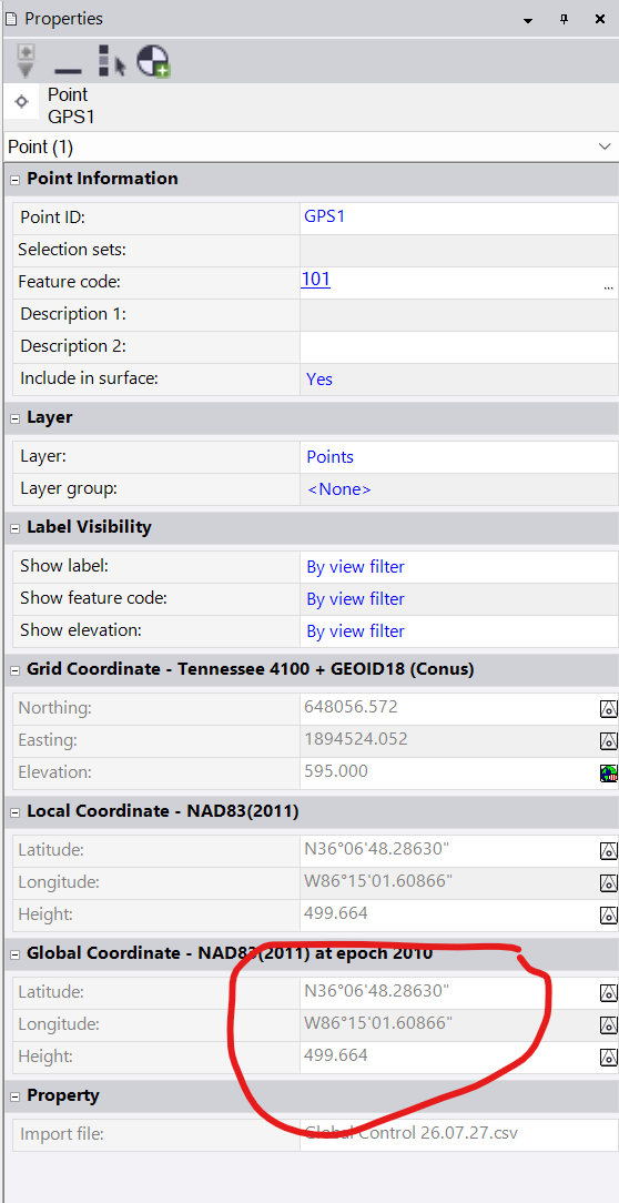

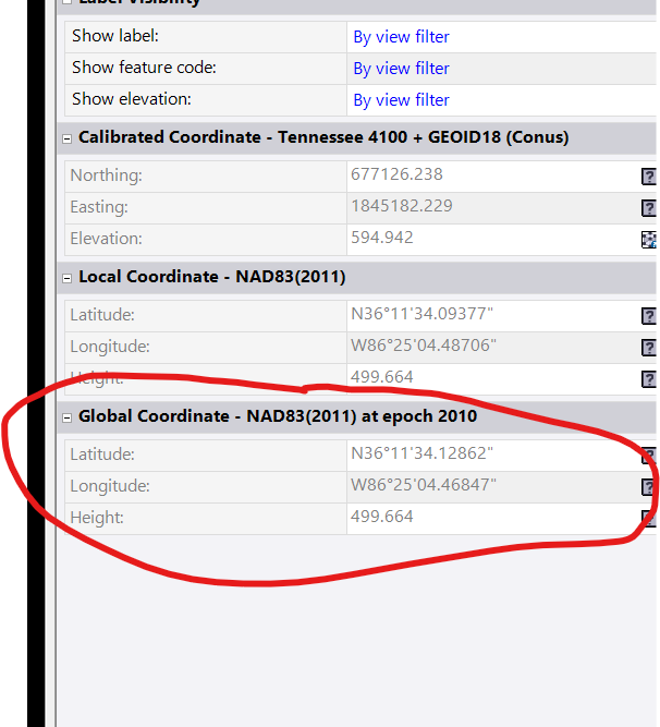

Here is a screenshot of the points in the importer. Looking at GPS1, after hitting import I get this as the point data that is created. It should be be N36 11.
it should be

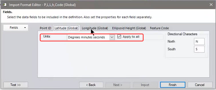

In your global point importer, check that you have it set to Degrees, Minutes, Seconds. The default setting is Decimal degrees
Thank you Ed, I think that was the issue.
You’re welcome Jason
