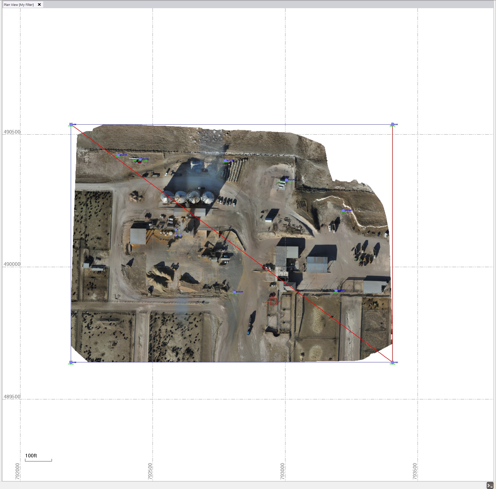

I started a new US Ft project - no coord system set
I dragged and dropped te DWG file - it has the drawing frame shown, and a Block Reference Miles away that has a small piece of text in it. I exploded and deleted the data miles away. I ten imported the TIFF file and I get this
Cordinates shown are 792000 E and 489500 N in the Lower left Corner and 793500 E and 490500N in the Upper right Corner.
The image sits on top of the frame from the DWG file OK
Are the coords what you are expecting?
They seem to match what I am seeing in Civil 3D?
