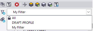

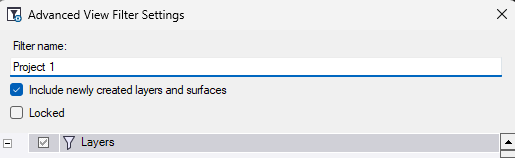

Why don’t you just make a different view filter for each project? I tend to just copy my filter and change the name to say project 1, then if you open the advanced view filter settings for your project 1 view filter there is a check box for include newly created layers and surfaces if you uncheck that. new things will not just be turned on by default in the separate view filters as you import/create new layers/surfaces.
