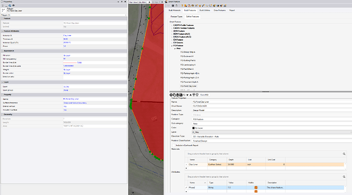

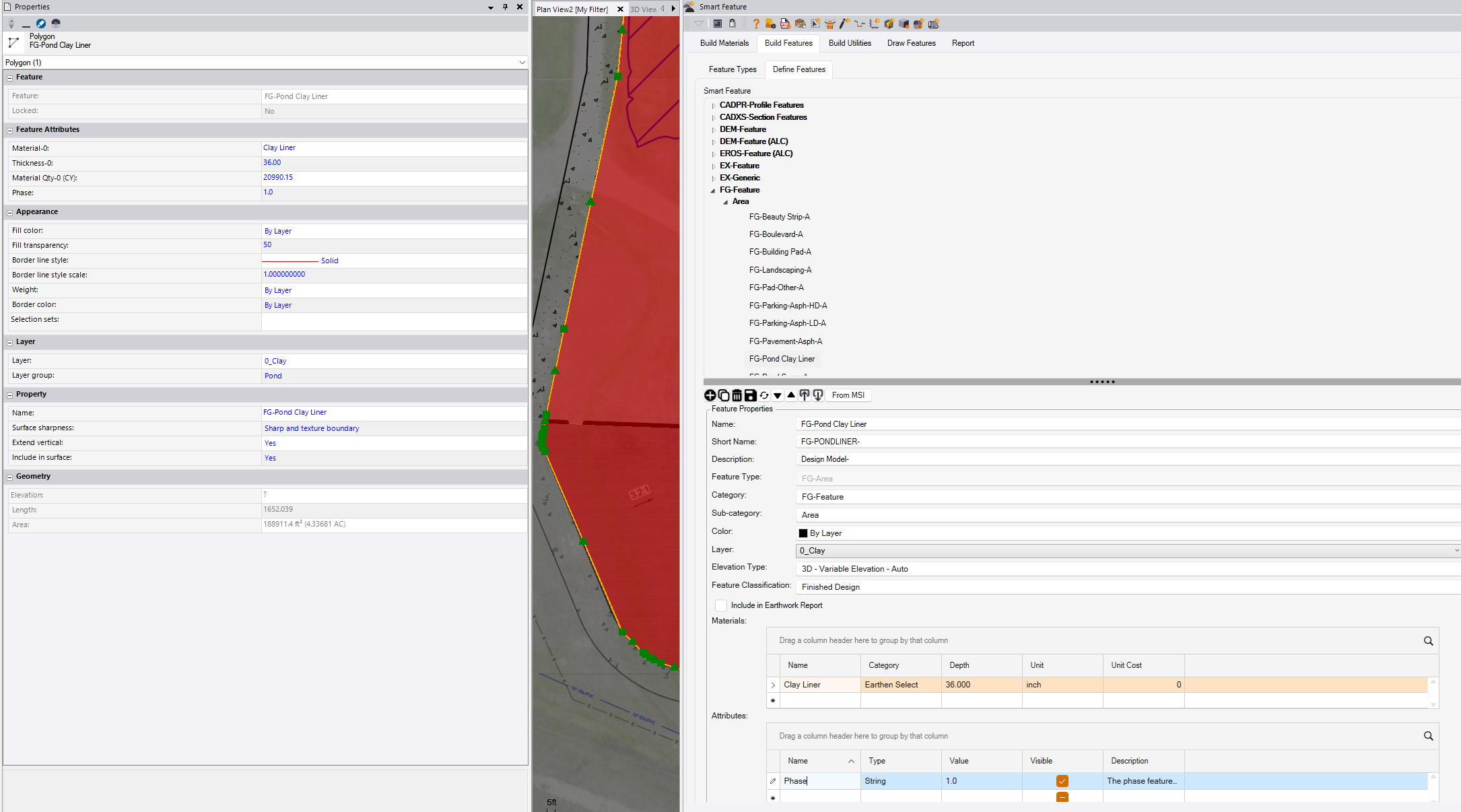

Under Build Features, Define Feature, at the bottom there is a Materials & attribute section that lets you apply a Phase and value. I have used this successfully for reporting, and it shows up in the properties tab when you select it.
I have found this Attribute; I just have not figured out how to include it in the report.
