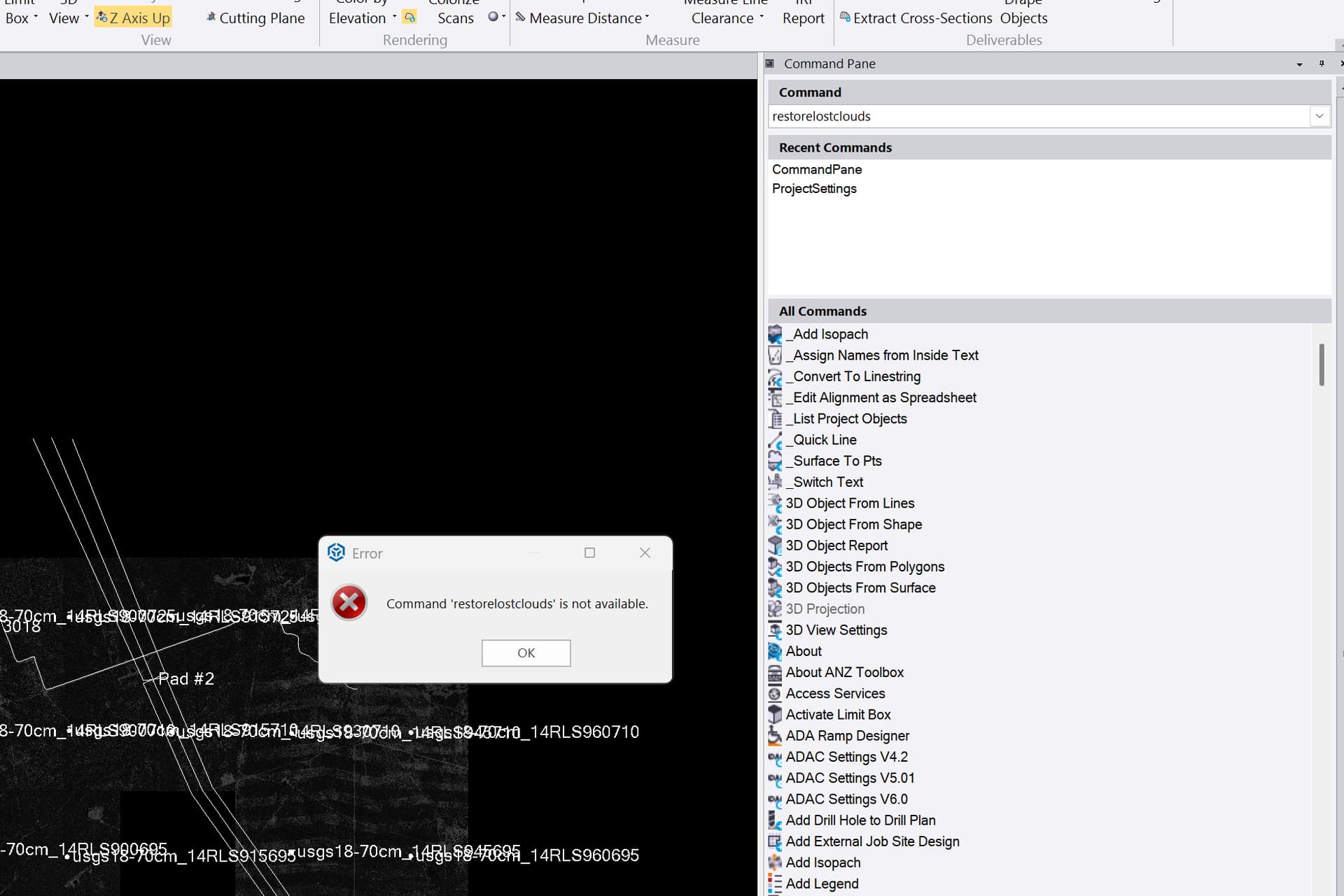

Try opening the command pane (F12) and type restorelostclouds. That will often work for me
Which version of TBC has that function? My 2025.20 does not. I have needed that function for 10 years.
Sorry, try rebuildlostclouds. I recently learned about it when processing a mobile mapping mission and kept having my ground classification disappear.
That should be a button on the point clouds ribbon. Thanks for sharing
