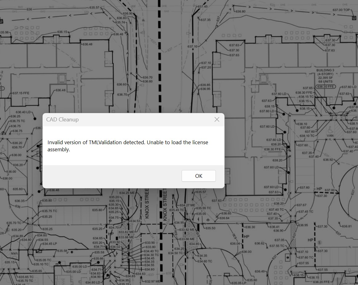

I am getting this error after the update. It appears to happen on all RPS commands.
Did you do the Installer package or use TML Status. If the latter you have to install the package first and then you can run TMLStatus afterwards
let me know if you used the installer package - if you did I would try installing again
Close down TBC
Wait 30 Secs
Run the installer package from our website downloads page
Restart TBC
Login to Trimble ID
Run Menu manager
Click reset RPS Menus and refresh Icons
You should be all set
If not email us and one of us can call to resolve - I have installed multiple times so far today and had no issues, so I don’t think it is an installer issue
I had used the installer package originally. I ran the installer again and everything seems to be working.
OK Good - thanks for letting us know

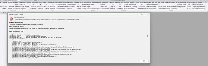

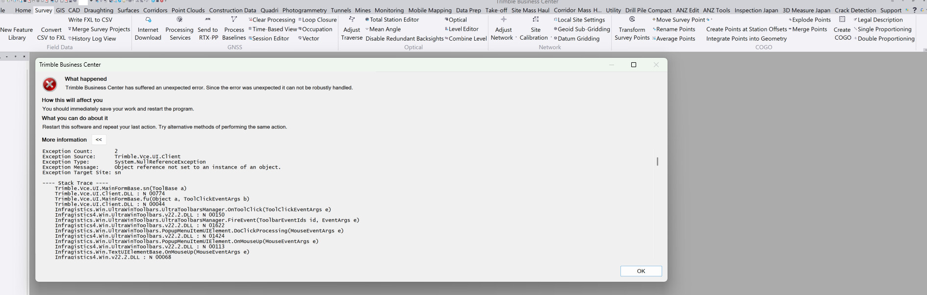

Over the weekend something has happened to my Laptop / TBC,
Trying to either open or create a new Project I get the following error:
If I accept this I get a TBC Ribbon menu that appears to show all options / modules - very strange…
But it won’t let me create a new project (greyed out) - if I select an option that is available it shows an error code as below and won’t continue

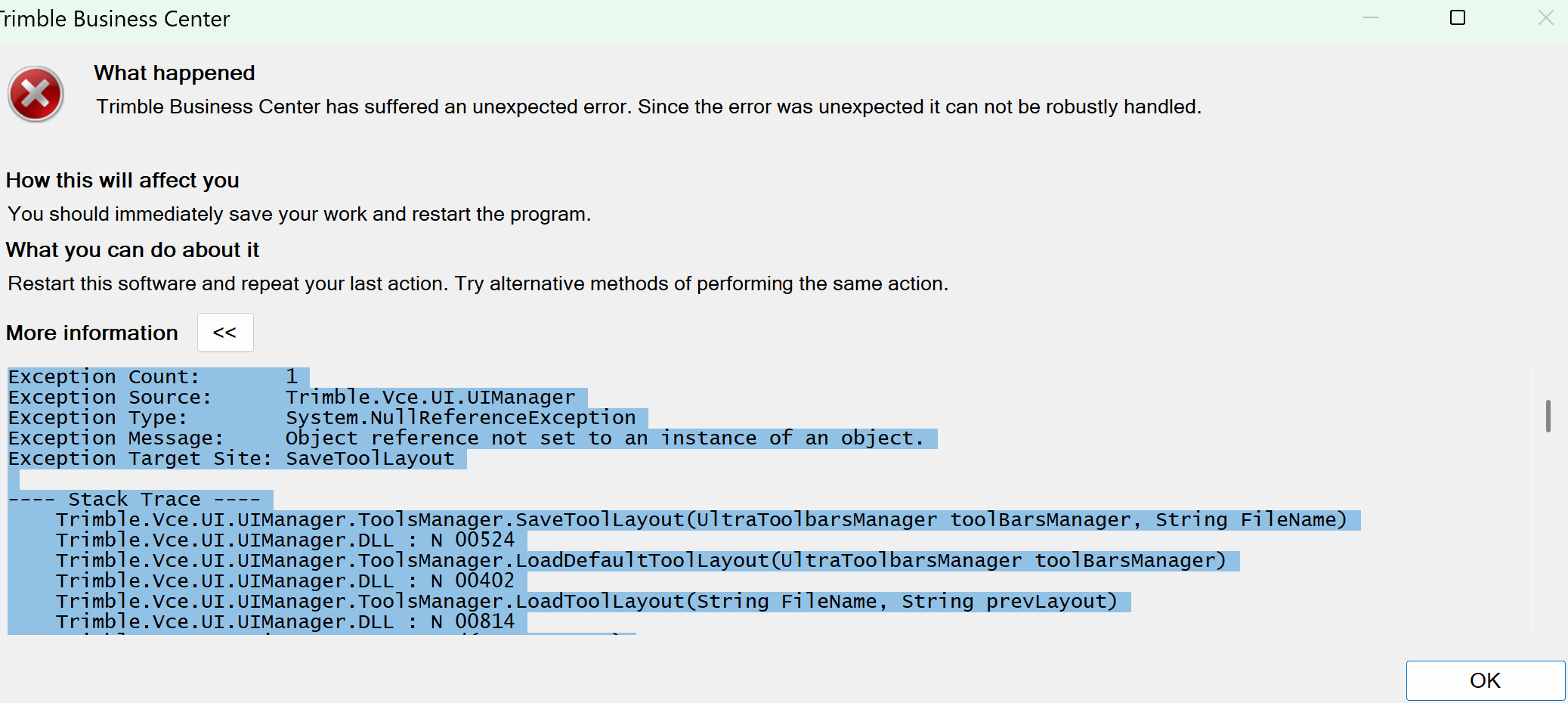

The errors that you are seeing look like they are all TBC Menus and Toolbars related - so while starting up it seems that it failed to load some component(s) correctly or that something was corrupted as you closed out the previous time.
If you go to the folder where your Project Templates are stored - mine is e.g. at this location if you are not sure and this is the default location
C:\Users\Alan Sharp\AppData\Roaming\Trimble\Trimble Business Center\43.0
So your path will be slightly different (Alan Sharp will not be yours), and 43 is for TBC 2025.x, i you are running an older version it will b 42, 41 etc. (the highest number is the newest version).
In that folder you should find files with these names
SurveyRibbon64.Layout
SurveyRibbon64.Layoutd
These are the last version of the Menu Layout and Toolbar layout that you saved on exiting TBC - try deleting these two files and then start TBC again - I think this may fix your issue.
I had someone else a short while back have a similar issue - I will try and recall who that was and he found a solution that worked for him (the issue may have been different but he had a similar problem starting up and opening a project) and see if I can find their email that told me what they did to fix their issue.

Deleting the two SurveyRibbon files seemed to do the trick - I’m able to start and access TBC ok,
It seems strange that the Trimble Cleanup Utility does not remove these
Resolved thanks - Alans deleting Survey Bin Layout files worked (I’d cleaned up and full re-installed a few times) very frustrating that the Cleaner Utility does not remove these
BTW Lenovo i9 , 64gb RAM, 8gb Video NVIDIA RTX 2000
It leaves those folders alone because that is where you store your custom Imports and Exports, Custom templates and other elements that you really do not want to lose from one version to another. When you install a new version, the first time you run it it asks if you want to copy your custom stuff into the new version - this e.g. creates a 43.0 folder (2025.1) and then copies the content from the prior version folder (42.0 for 2024.x) but leaves them all alone (you will find that if you have used a number of different versions over the years on the same PC that you have a 39.0, 40.0, 41.0, 42.0, 43.0 folder - this allows you to hunt back and find something you had set up previously.
If Cleanup blew all these away, people would be even more frustrated because it is very likely that they don’t have these backed up (many people don’t even know these folders exist), and they would lose a lot of custom stuff that they have setup.
