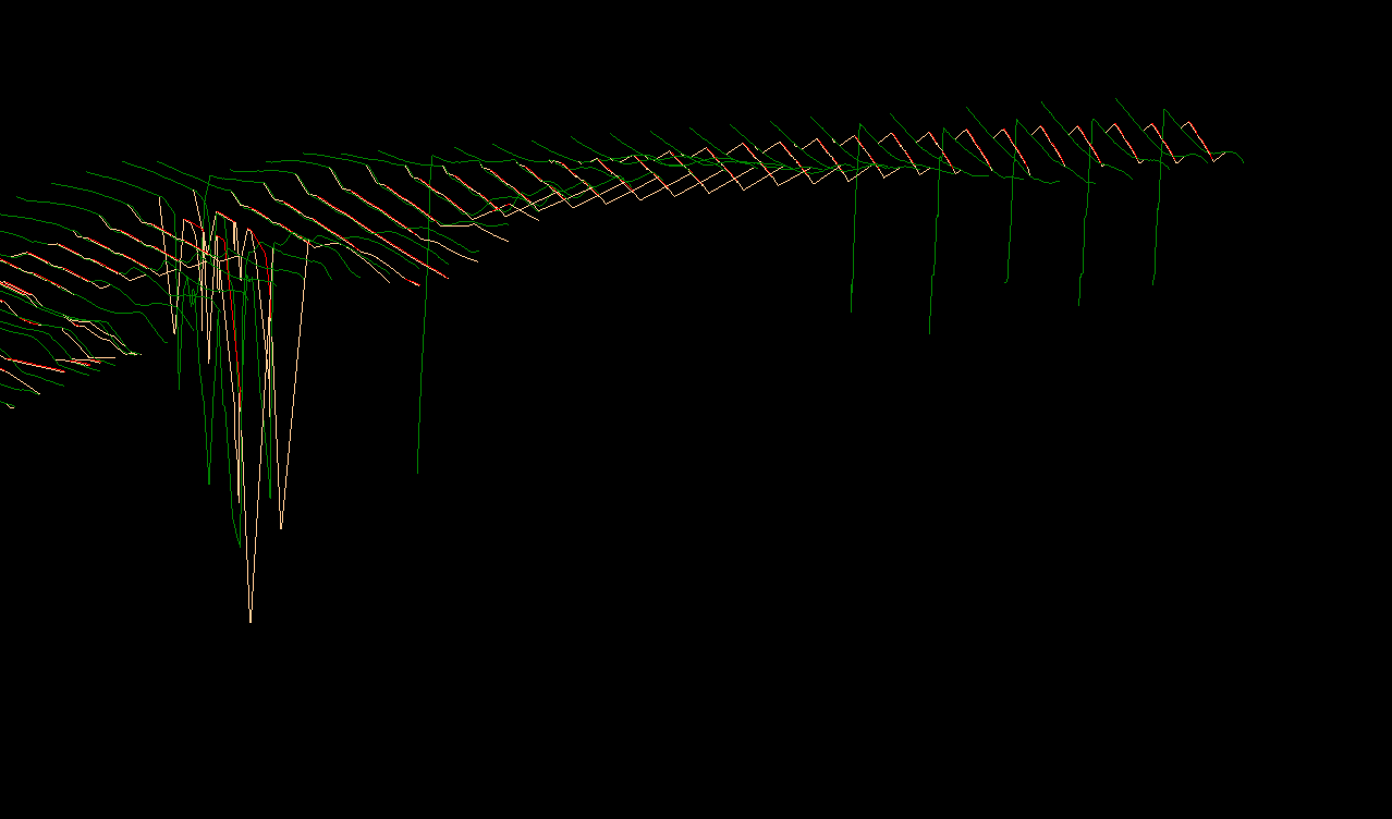

When I try to flip cross sections I have created from PDFs, I am getting spikes in the data. This only happens when I try to flip more that 1 cross section at a time. The data ranges from single sections per sheet to multiple sections per sheet. Even if I flip them up sheet by sheet sometimes the error will still occur if there is multiple sections on the sheet.
Ill step in for a bit. From my experience, it is due to the text spacing setting being to close or off.
Ive seen this for a few different reasons, Min grid distance is picking up parts of another cross section, solution tighten up the max grid spacing. second is if you had to put in elevations for your offsets (due to no text existing in the data.) and the elevation you elevated did not cross the data from that cross section.
