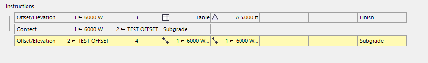

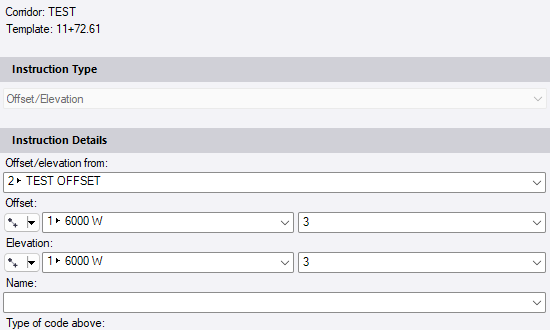

Joseph. since TBC now builds the lines for a corridor you can USE the RPS Offset slope command ( Offset Slope Command ) use your bottom face of wall as the the offset line, then add that as a reference line into the corridor, then in corridor. use connect from bottom face of wall to bottom back of wall. then the next corridor command would be from the back of wall node offset/elevation, offset set it to node to node and select your bot face of wall to your top face of wall, and repeat on elevation. this will automate what your trying to do.
