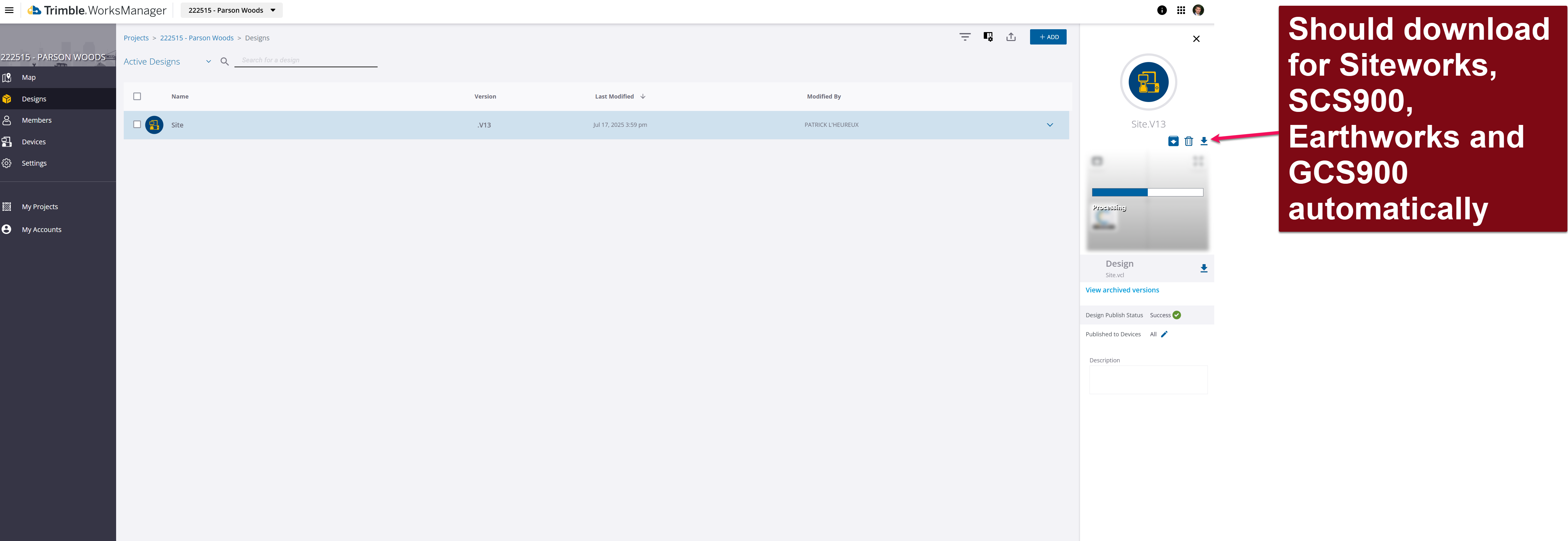

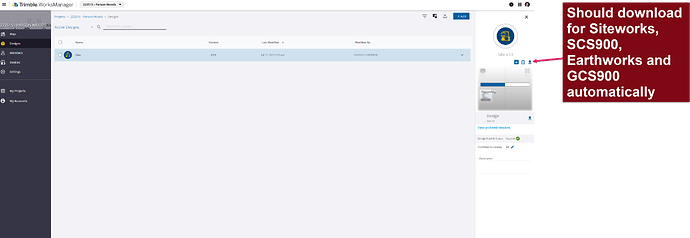

When exporting designs to WorksManager from TBC in the Construction Data tab. I would export to USB which will create the folders for GCS, SCS, Siteworks and Earthworks along with the design for each software in the appropriate folder on to the designated drive/usb.
You should be able to do this with no tricks if you are publishing from TBC. Even if you publish individually for machine control and Controllers. The download button should convert into the necessary files without having a machine assigned.
