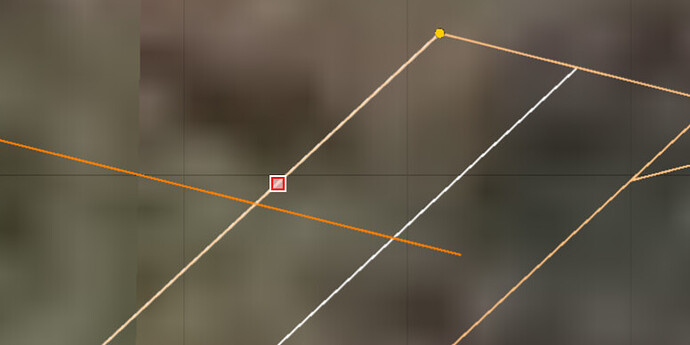

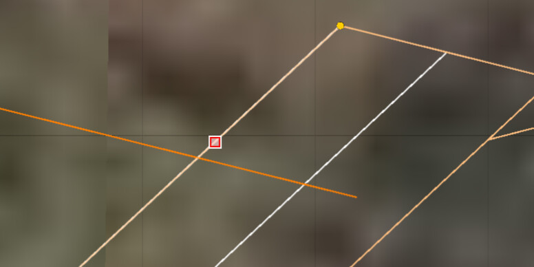

There are even cad-grippy things in the Design review from WM…couldn’t tell you what they do just yet beyond showing line/end line, but i am sure big thigs await. disappointment or otherwise :wink: It also would appear that 3D viewer will bring some additional functionality for review of both design and field measurements, at a “Pro” price point of course. The Netflix model for services is getting annoying for sure though. Imma-bout 10 bucks a month-ed out.
