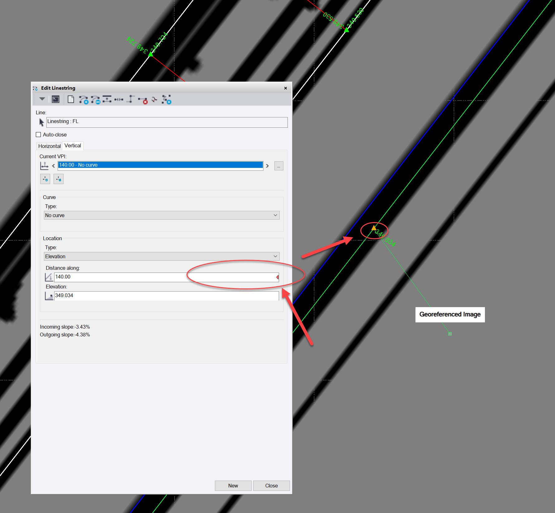

I’ve noticed in 5.7 that After joining two lines with the same elevations on both ends, TBC keeps two identical VPIs at the same location. I don’t think that was the case in the previous versions of TBC
  1. Is there any settings I can change to prevent that from happening ?
  2. Is there an easy way to remove duplicate elevation points from a line?

I concur with the comments about pain created from extra VPIs being created when breaking, joining, filleting, etc. I’d like to also be able to snap to a VPI.
@Vitalii_Vovk, have you tried using the RPS Optimize Linestring command for cleanup?
I agree that the RPS Optimize Linestring command is the best option to deal with this issue.
