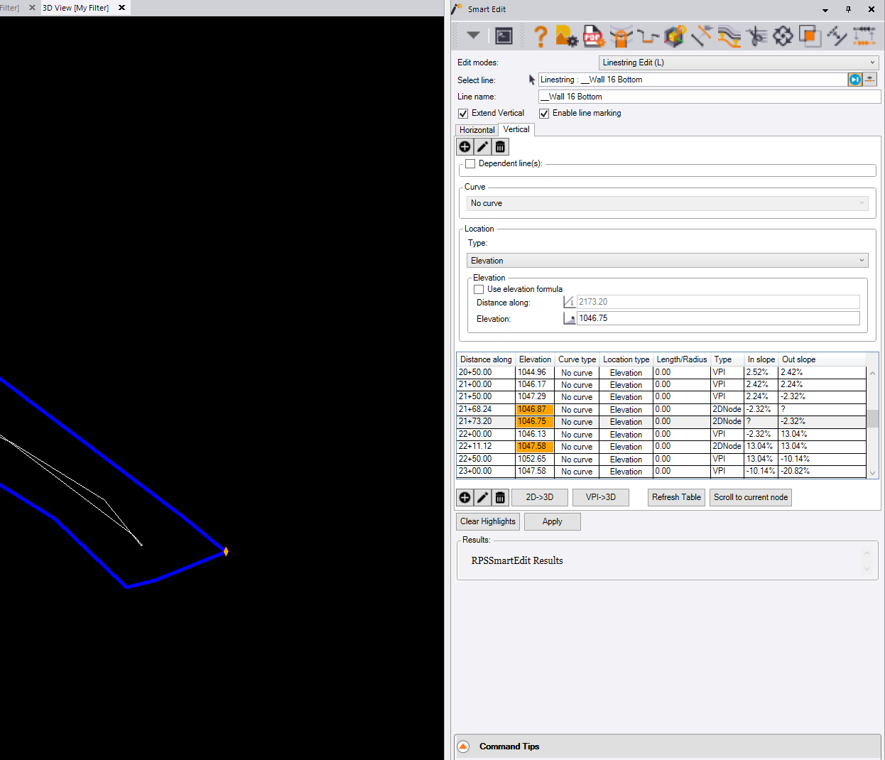

Open Smart Edit, go to the Linestring Edit mode and select the linestring. Once the command populates with the data, go to the Vertical tab shown below.
You can see in the elevation column, some of the elevation are highlighted orange, this denotes an elevation that’s being interpolated from the elevation on either side of this node. If you Break a line at this point, there’s no way to accurately calculate that elevation.
To fix this issue, we need to change these interpolated elevation to hard elevations. This is accomplished by using the 2D>3D button below the Elevation column. Once that is done, we want to hit the button next to it to convert the VPI’s to 3D nodes.
The reason for that is because of how the VPI is calculated. These are put in as a distance along the line. When you break the line, now you have 2 lines and they are shorter than they were. Because of this, you’re elevations will not be correct. Once they are converted to 3D points, you can break the line and you’re vertical will hold as you want it.
