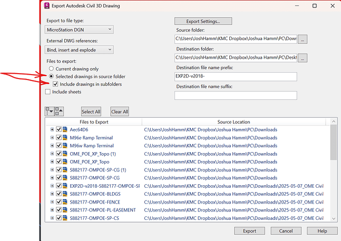

Then, I initiated the export process. At first, my exported .DWG files would crash TBC or cause it to hang indefinitely. But here’s the trick that finally worked:
In the export dialog, I toggled on “Selected drawings in source folder”
I also checked the box for “Include drawings in Subfolders”
After enabling those options, my single Civil 3D export turned into 13 EA .DWG files. When I brought them into TBC, everything imported cleanly—linework, surfaces, and all.
It took some time, but this process saved the project and eliminated the dependency on repeated designer exports. Hopefully this helps someone else dealing with similar headaches.
Let me know if you’ve run into the same and have other tips.
