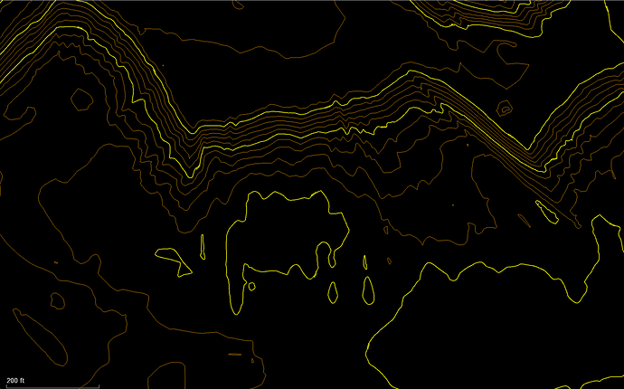

Here is a set of contours generated using 25,2,1.0 settings
Here is the same set of contours generated using 25,2,2.0 settings
And the same set of contours generated using 25,2,4.0 settings

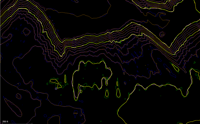

When you overlay all of them together you can see that even though the underlying surfaces have undergone significant smoothing, the end result contours follow the same general path but are smoother. This is actually a better technique than trying to smooth the lines because then the lines are not being generated by a surface model and as a result can cross over each other. Using this method the contours are still being built by the surface model and have the same “crossing contours” checks in place, yet are smoother and "more pleasing on the eye. Note that the contours generated from the smoothed surface will not match the less smoothed surface, however are approximately the same, just don’t have all the spikes and dings that the unsmoothed surface generates.
