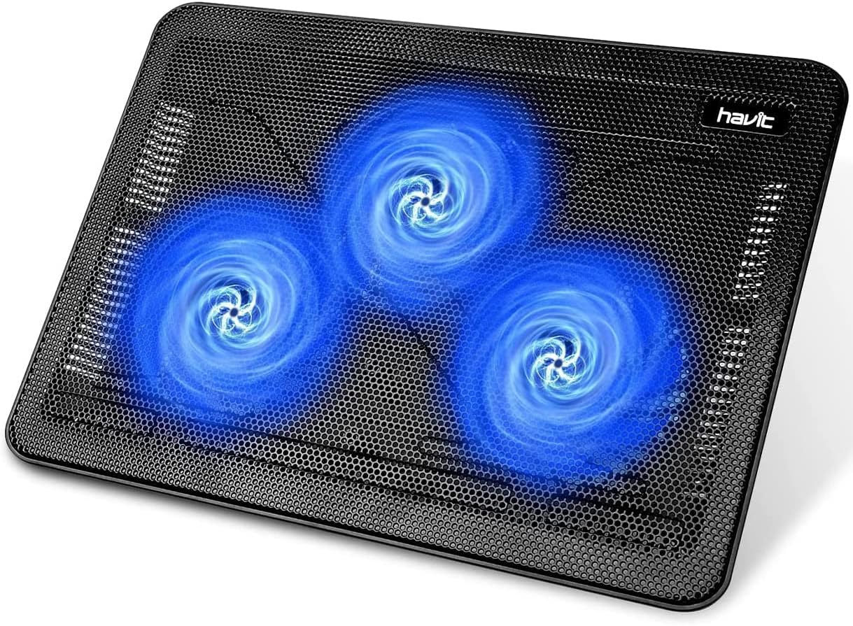

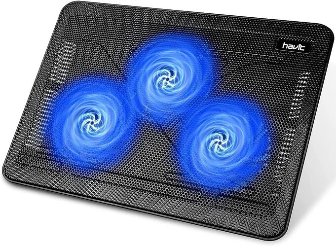

I’ve added one of these fan boards to my laptop and have seen a pretty nice boast to speed just being able to move more heat off the components likely a good bang for the buck.
Even with a high-end workstation, this is a solid move! I’ve got an older precision laptop from 2020 and it still runs strong. I can’t help but think its longevity and stability under heavy loads is directly tied to the $25 fan sitting under it.
