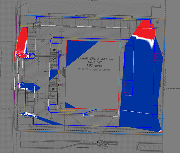

I am having an issue with a C-F map not generating properly when generating it to the SG takeoff surface. See phot attached. This is the first time i have ever seen this and it work fine with every other surface in the project. I am only having the issue with the SG takeoff surface?
Anyone have any experience with this? Or any suggestions
. It must be something simple but i cant figure it out.
Thanks in advance.
It is in the isopach surface somehow but I do not know what.
What are the Max Edge Length Settings set to in the Isopach Model - it is likely that or you have some boundary added to the isopach that is limiting it in some way.
If you cannot solve it, send me the file and I will take a look for you
Alan,
Following your advice and i got to checking boundaries and found a gap in the surface edge that was very small but it ran inside the parking area along a curb line and was throwing everything off. Tied that together and everything came in line.
Thanks for the quick response.
Good to hear! Glad to be of help
